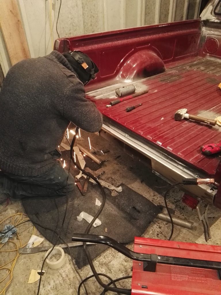

    So tonight's project was to bond the fibreglass rear panel on. The panel was advertised as just bonds straight on, does it fuck. The first problem was it was twisted so had to put a few screws in to hold it while it sets which was no big deal. The second problem was the tailgate catched which after a lot of moving and pulling the panel we realised it was the hinges that the tailgate stits on that were worn. My solution was to build a little weld on the top of them to stop it catching as it opens and worked like a treat. Next week moving onto driver's door.
    Wait, what ?! If there's any sort of genius bodgery going on, I wan' see
    Usually the tailgate has a bow in it, so when lowered the centre section is lower than where the hinges are.
    Sure that isn't the issue?

    Not genius at all, just a bit of weld lol

    Yes did have that problem in the center which made it catch.
