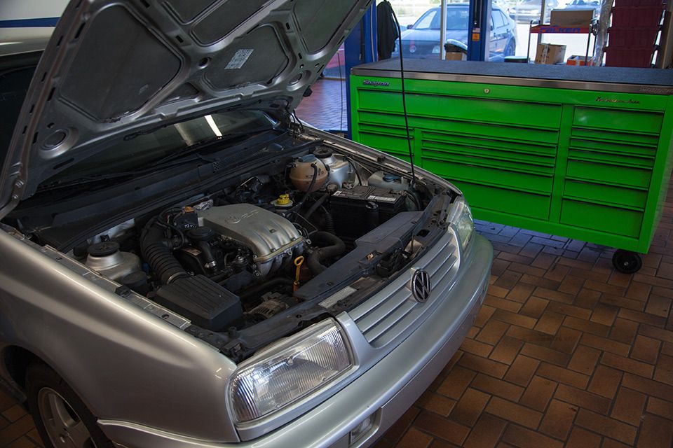

    the original setup.

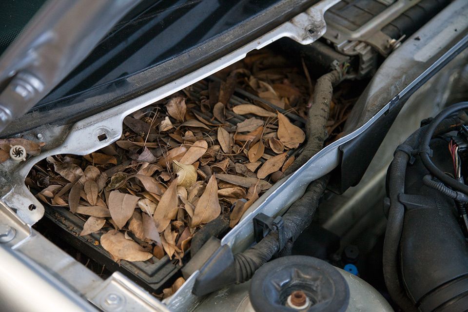

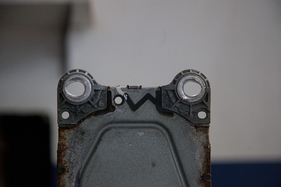

    something I found when I started to tear the car down.......

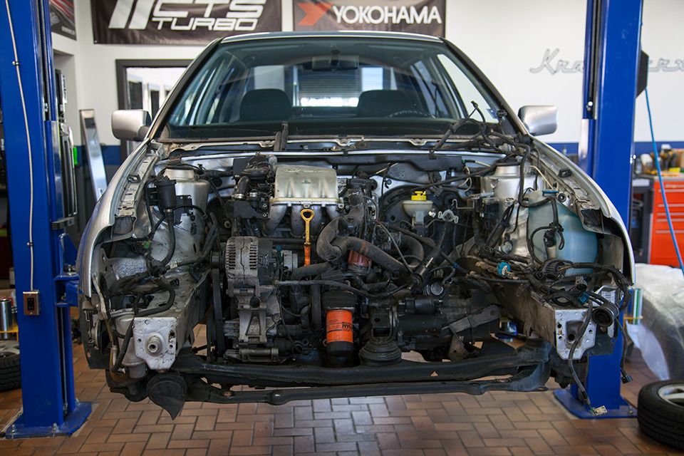

    exhaust off, heat shields off, shifter removed, fluids drained, axles removed, etc.
    more of the tear down.
    engine bay cleaned up and ready to start work on.

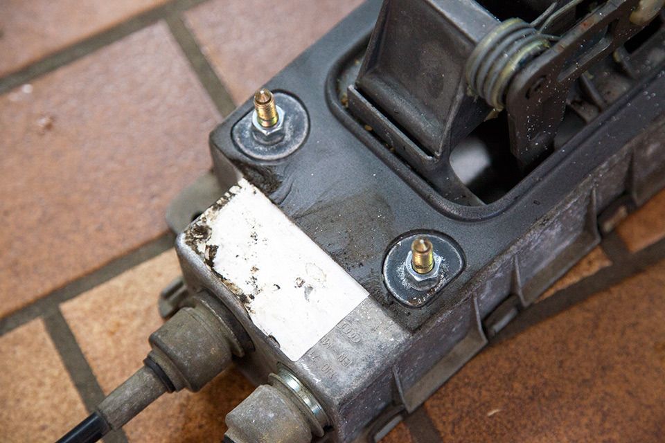

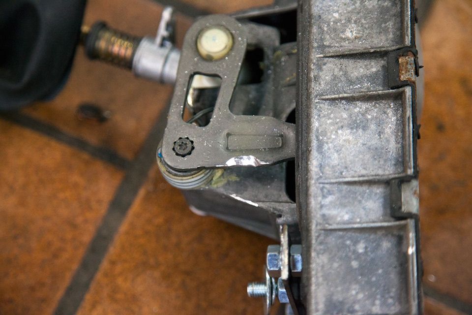

    modifying the MK4 shifter to work, really pretty simple to do, started by modifying the mounting holes a little, then made a very simple bracket, and it bolted right in.
    the only issue is this piece rubs on the edge of the shifter opening, so I trimmed it very slightly, rather then cutting into the tunnel/opening for clearance.
    Shifter in and mounted.

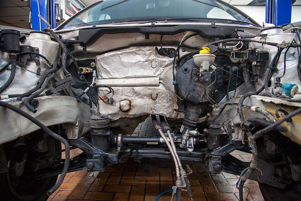

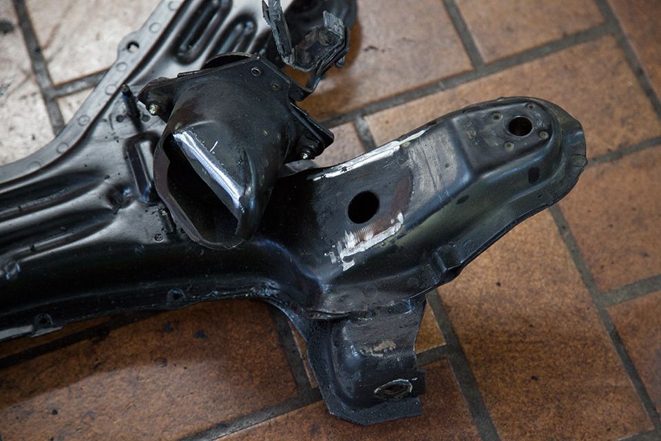

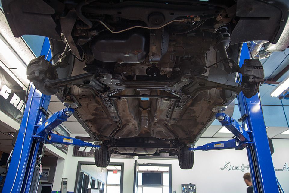

    I had to drop the subframe,
    cut the cup for the transmission mount off the subframe
    bolted the cup to the new mount set the subframe in place and tacked the cup in place,
    removed the subframe, installed the heat shields, downpipe then welded the cup to the subframe and put it back in place.

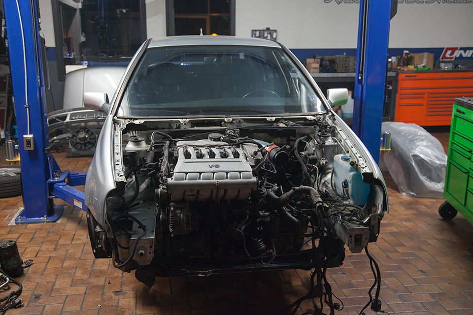

    installed the engine.

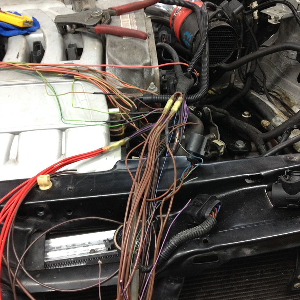

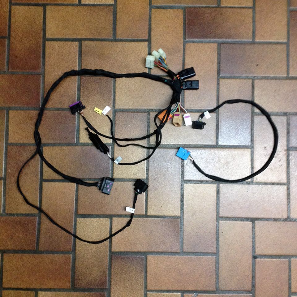

    I bought new control arms, steering rack boots, sway bar links and installed them. Then I started on the tedious work of the wiring harness.

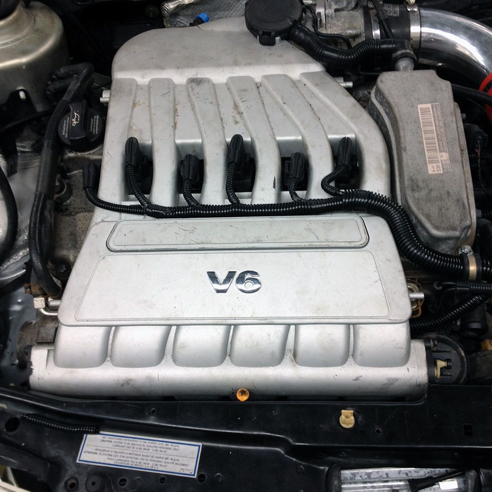

    I separated the 2.0L engine harness from the stock MK3 harness, retaped the MK3 harness. The engine from the MK4 had a 2.8 harness
    so the wiring did not lay properly on the 3.2 engine, mostly just the wiring for the coil packs was not right. I had a good portion of a 3.2 harness
    that had been cut from another car and spliced the wiring for the 3.2 coil packs.
    I was part way through the job when I started to take some pics.
    and the Stance Dubs swap harness.

    It runs

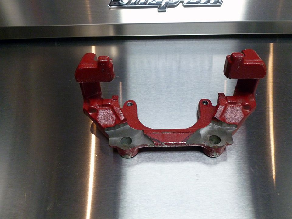

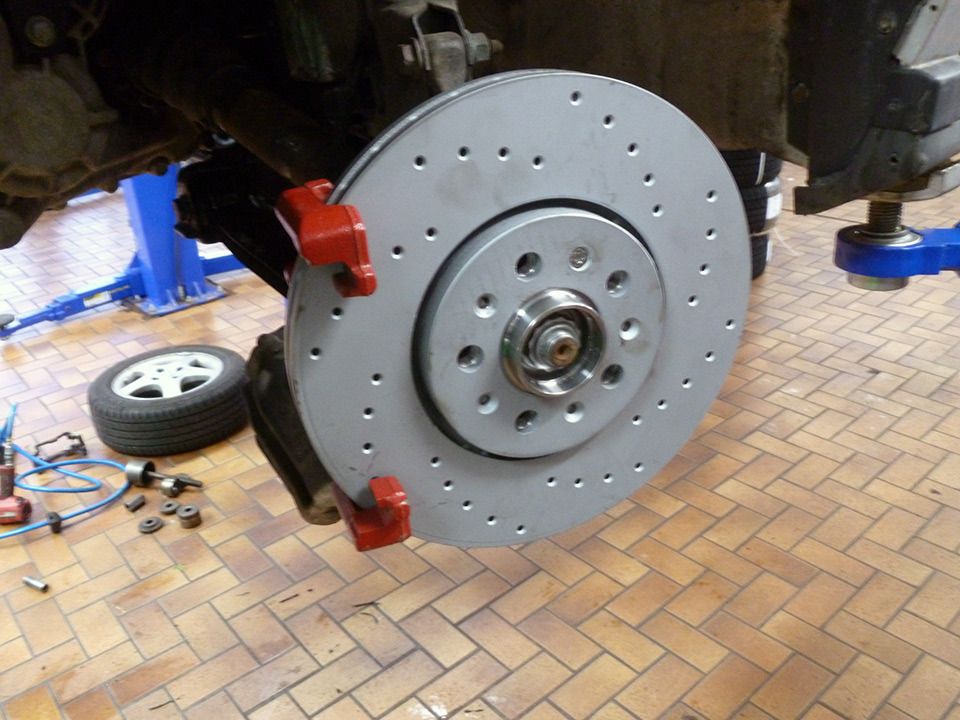

    MK4 1.8T front discs installed on 2.0L spindles, the carriers were milled for proper offset.

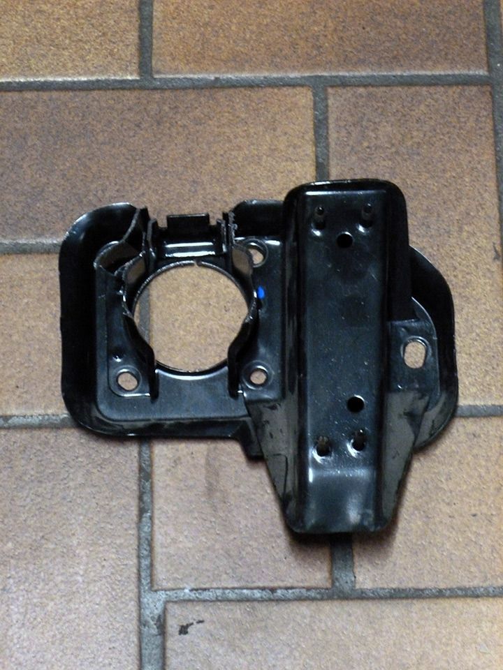

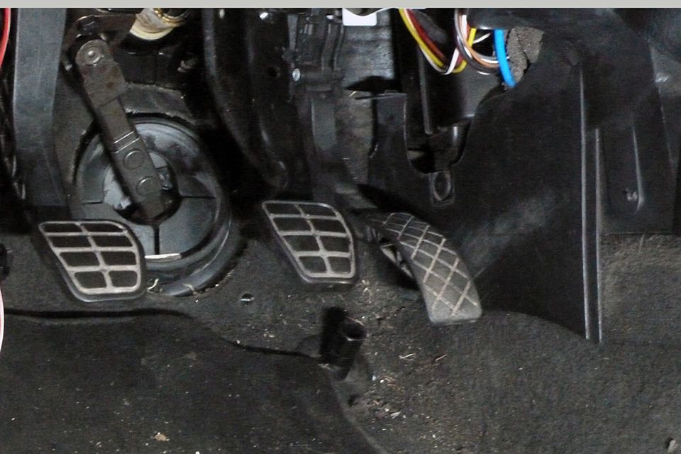

    I cut the pedal support for the DBW out of a MK4, I am going to drill out the spot welds and separate the pedal support bracket, it uses the same bolts as the brake booster.
    not 100% sure the studs from the brake booster are going to line up but look very similar, I'll have to use a rivnut for the right hand bolt hole.

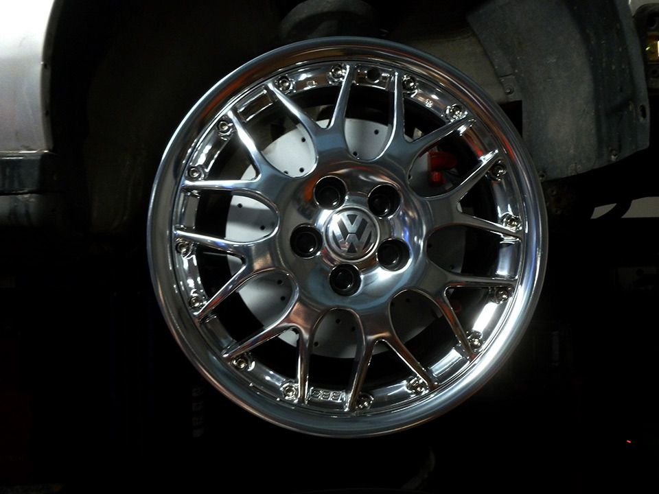

    Finished polishing one of the RXII's
    Test fit, tomorrow I'll be cleaning up and painting the MK4 GLI front calipers and installing them.
    I drilled out the spot welds and separated this piece of the MK4 pedal support and it fit onto the MK3 brake booster studs,, then I marked and drilled a hole for the
    3rd hole on the right side and used a rivnut, the throttle pedal bolted in perfectly. Lines up with the stop on the floor but the stop is a little too short, I'll have to adjust or lengthen the stop a little.
    I cleaned up the MK4 GLI calipers painted and installed them.
    Too much bling? Not sure if I like the wheels or not, kind of wanted to go for the stock/sleeper look.

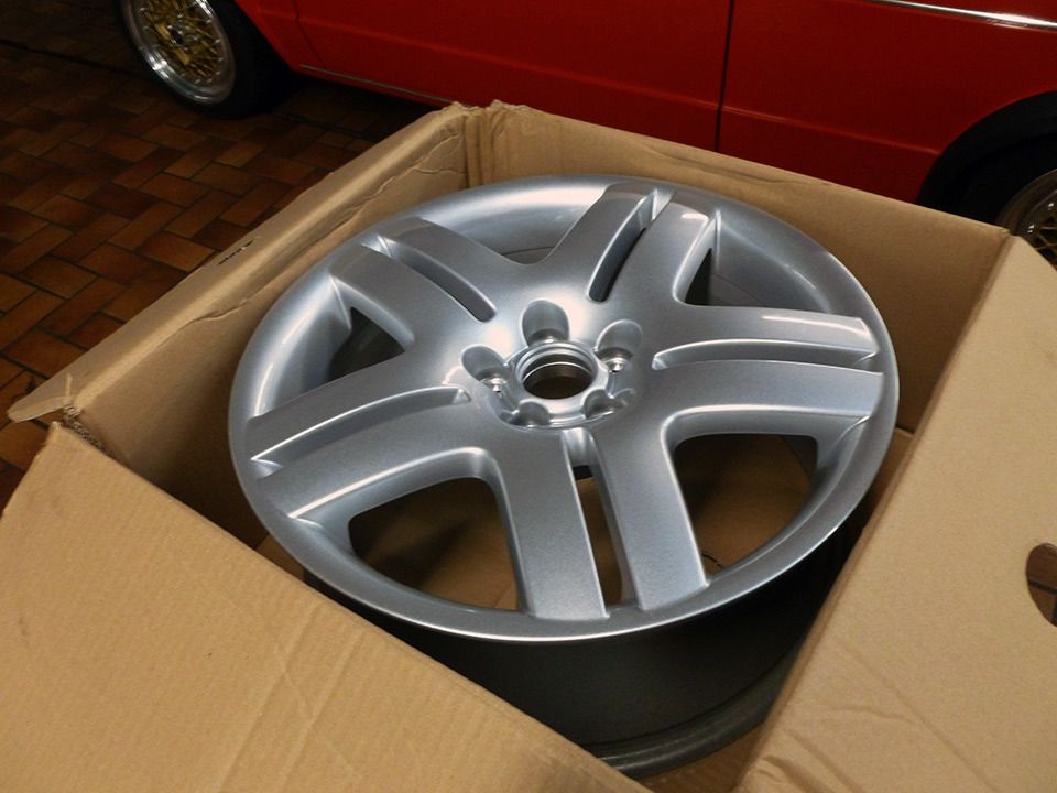

    I like the RX2's but don't think they suit the car and what I am trying to do, I ordered a new set of Long Beaches from VW, I have always liked them and think they will look better then the RX2's.
    I do have a 2nd set of RX2's I could swap the centers and try them, but think I will leave them as they are and use them on one of my other vehicles.

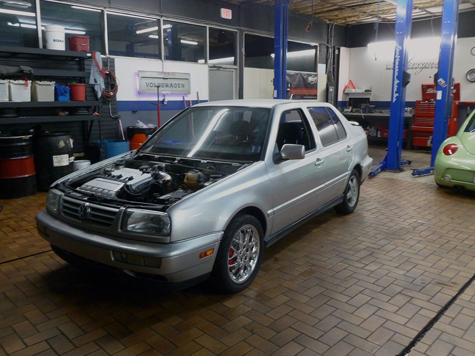

    I had the axle shortened, had a new line made up for the A/C, from the compressor to the condenser, needed to be 3" longer now it fits perfect.

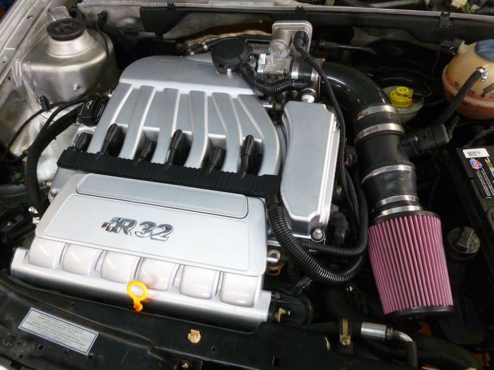

    I removed the intake and valve cover and gave them a coat of base/clear in reflex silver and put it back together, filled all the fluids and played with it in the parking lot, works well and think it will be a fun car.
    Now I just need to tidy up the engine bay a little more and make something for an intake tube.....

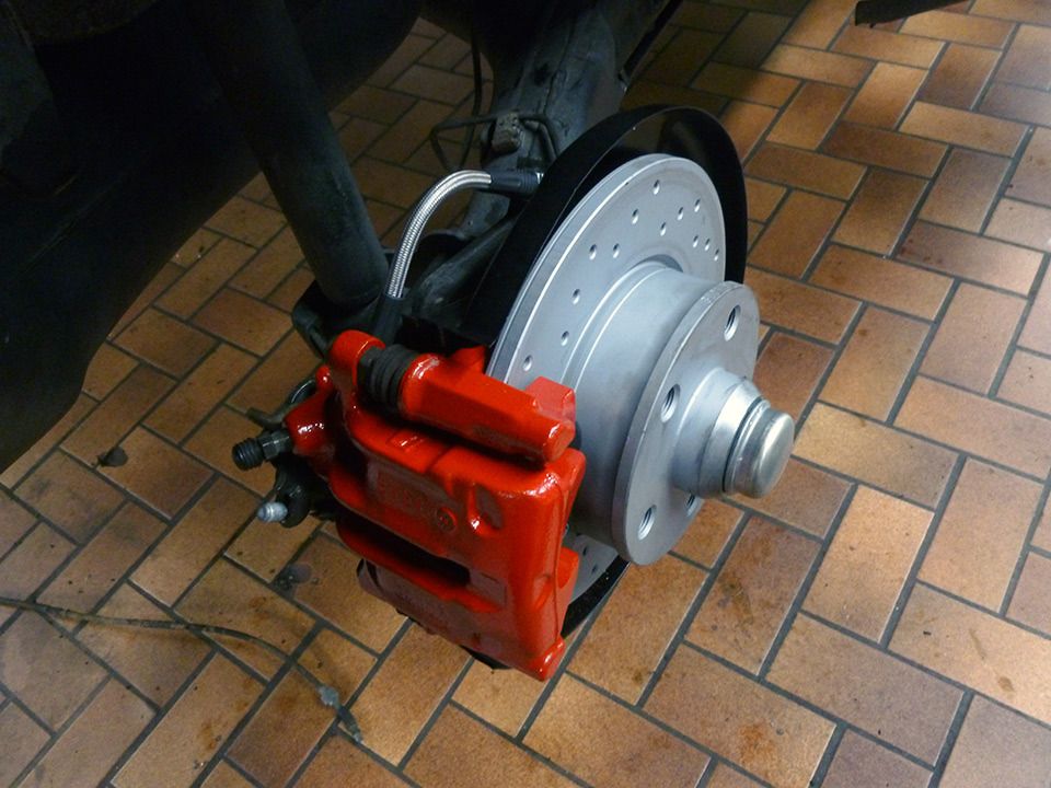

    Finished up the 5 lug conversion with a rear brake job also installed SS braided lines, new ebrake cables, mounted the tires and wheels, installed some H&R springs.

    Finished up the intake and filter.
    Just sorting out the A/C and cruise control, new wheels and tires arrived.
    new long beaches from VW.....
    and some new rubbers.....
    Long Beaches on....
    Think I need a little less wheel gap to pull these off properly.....
